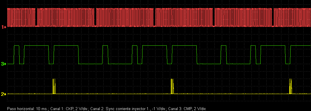

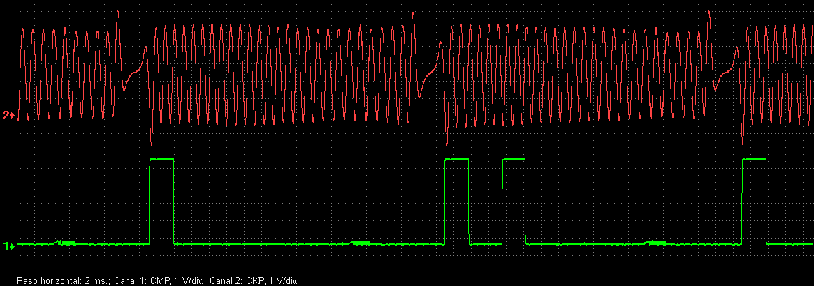

Post by knyshmotors » Wed Jan 18, 2017 3:25 am
Audi A4 motor AVF
Audi A4 motor AVF.png (10.61 KiB) Viewed 15657 times
Audi A4 motor AVF_1.png (10.27 KiB) Viewed 15657 times

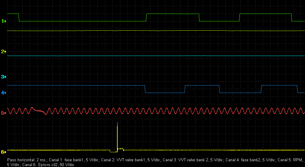

Post by knyshmotors » Wed Jan 18, 2017 4:04 am
Kia Magentis/Carnival 2.7 / Hyundai Santa Fe 2.7 nafta V6 2009. sist. de iny. Mu1.0 motor G6EA
Kia magentis 2.7.png (6.21 KiB) Viewed 15655 times
Kia magentis 2.7_.png (5.54 KiB) Viewed 15655 times

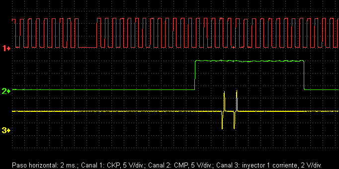

Post by knyshmotors » Thu Feb 02, 2017 5:46 am
Ford Ranger 3.0D SID-901
Ford Ranger 3.0D sid 901.png (3.28 KiB) Viewed 15482 times
Ford Ranger 3.0D sid 901_.png (3 KiB) Viewed 15482 times

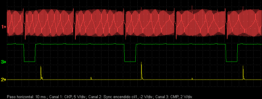

Post by knyshmotors » Wed Feb 08, 2017 3:19 am
Peugeot 307 2.0HDI 2007 EDC15C2-1x
peug 307 2.0HDI EDC15C2-1x.png (4.44 KiB) Viewed 15466 times
peug 307 2.0HDI EDC15C2-1x_.png (5.48 KiB) Viewed 15466 times

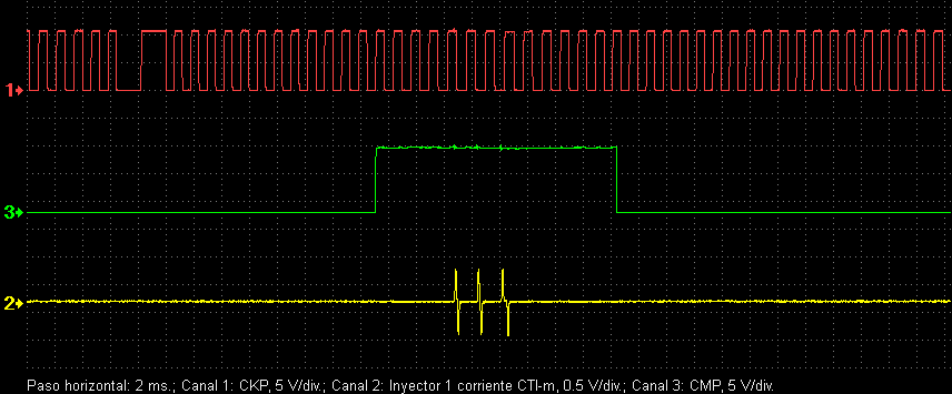

Ford S-Max 2.0 TDCi ECU: SID 206
motor sin fallas.
Ford S-Max 2.0 TDCi SID206 CKP_CMP Syncro.1.png (4.24 KiB) Viewed 15058 times
Ford S-Max 2.0 TDCi SID206 CKP_CMP Syncro.2.png (3.39 KiB) Viewed 15058 times
