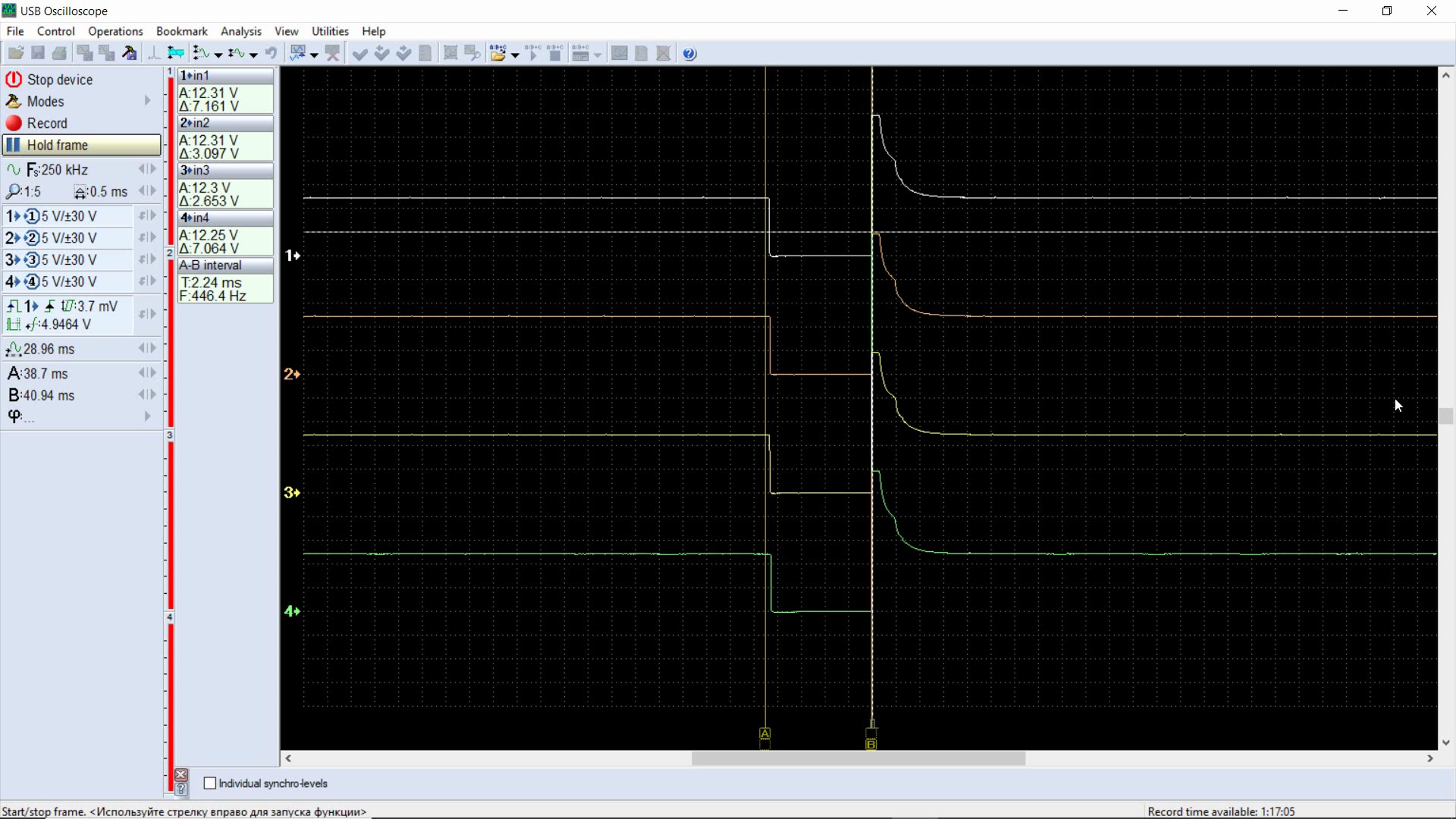

In modern engine management systems, the control pulses for gasoline injectors are spaced in time.
Because of this, it can be difficult to compare their shape and duration.
Mode called Injectors_Raster.upc is designed to work with time-separated signals coming to different channels of the oscilloscope.
This mode displays pulses in the form of a raster, which allows to compare visually their shape and duration.
Injectors Toyota Corolla 1.6 2019.png (2.4 MiB) Viewed 37780 times

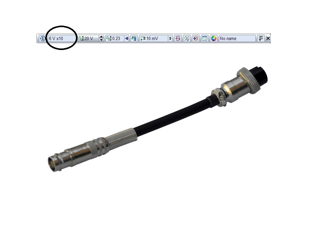

Hello Diogo! I have an adapter to Pin3/Bnc and i use the cable of laboratory scopes 10:1. And Change settings
Pin3- bnc Adapter e.jpg (52.63 KiB) Viewed 9815 times
