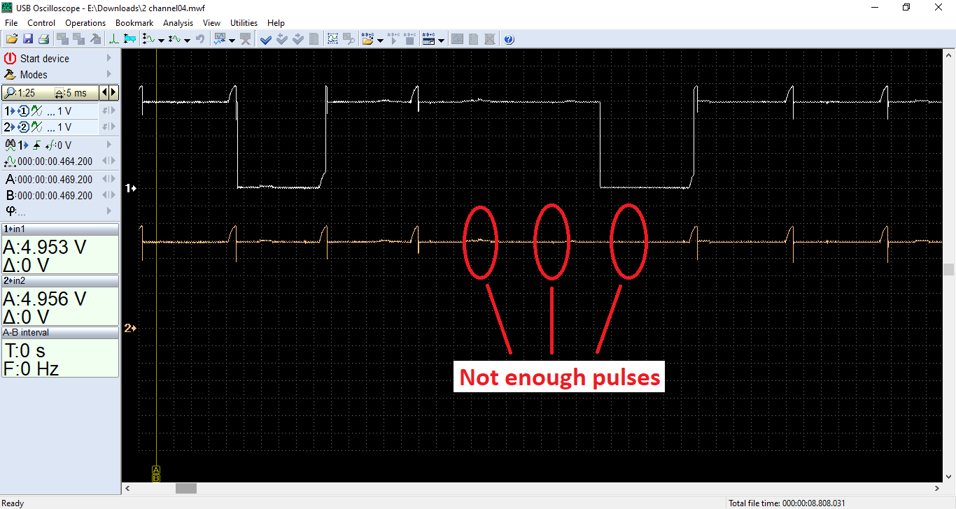

hi all this my first post on this forum i Mitsubishi 2012 when he get hot after 1 hour engine stall and rough idle but when scan no trouble code recently customer replace fuel pump
i check signal crank and cam i am not expert but i think the crank signal was not good
any one tell me whats the problem

Re: crank and cam sensor mitsubshi
Apparently, you have incorrectly connected the black crocodile of the device's power cable: it must be connected to the car body;
You connected it to the "-" battery terminal. Because of this, inductions from high currents flowing through the car ground are superimposed on the useful signal. In this case, we see that on crankshaft and camshaft sensor signals current inductions from the ignition coils are superimposed.
Usually, such interference is regarded as a negative effect that makes noise to the signals being picked up. But in this case, thanks to this noise we can see when the engine control unit sent control signals to the ignition coils.
I have looked closely at the waveform and I see that the cause of the misfire here is a malfunction of the engine control unit: time to time it stops giving control signals to the ignition coils.
hello
thanks for replay me and tell where i am wrong
yes you are right the negative clip connect the battery
in this case the crank sensor grip not good change the grip and problem solved thansks

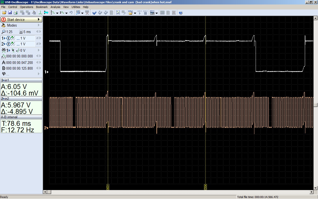

crank and cam (bad crank)when hot.mwf- (3.19 MiB) Downloaded 954 times
12.72 Hz = 763.2 RPM
Between these measured "spikes" there is an intrusion at the CAM and CRANK positions sensors. That intrusion may be within the harness or a defective ground connection. Look for possible water intrusion within the ECM. The intrusion needs to be solved because the "spikes" are what is "confusing" the ECM for the number 1 cylinder position and the correlation of the cam sensor. Use the saved file to slide the reference lines and measure this yourself.
- RPM measurement
- 12.72 Hz.JPG (433.59 KiB) Viewed 29927 times
