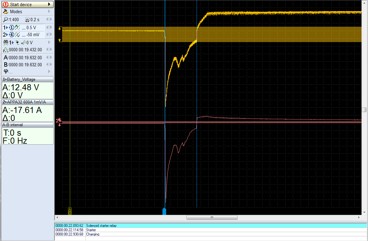

It's so simple. Here is the video as the test proceeds.Obviously a USB Autoscope device and a clamp ammeter is needed.
https://www.youtube.com/watch?v=it3bnjzVonQ

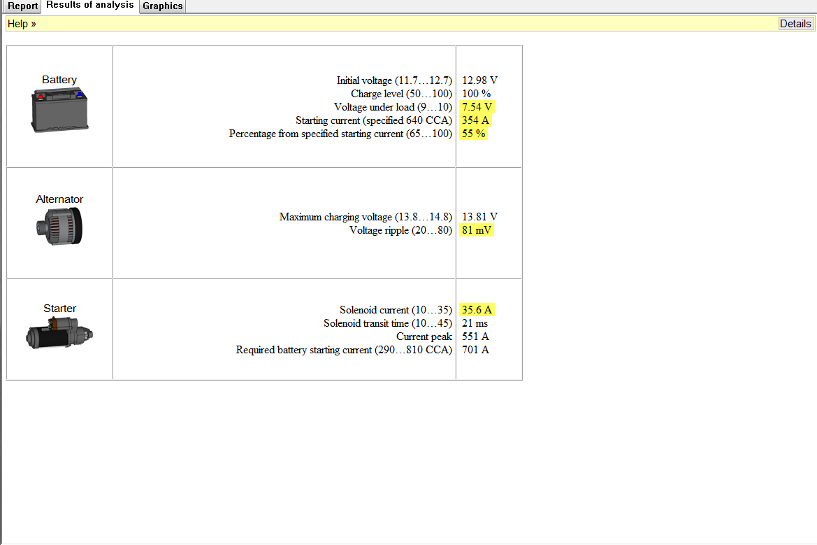

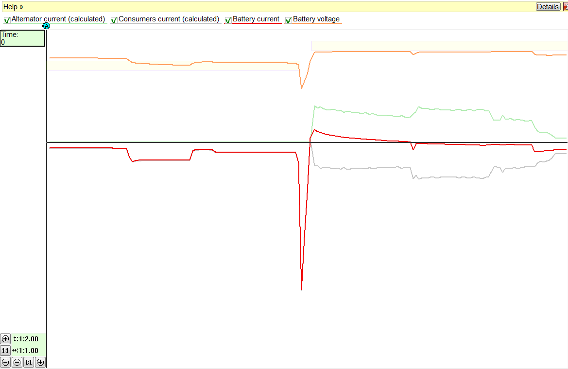

I have used this script many times. It is very fast and accurate. This vehicle had a weak battery.
