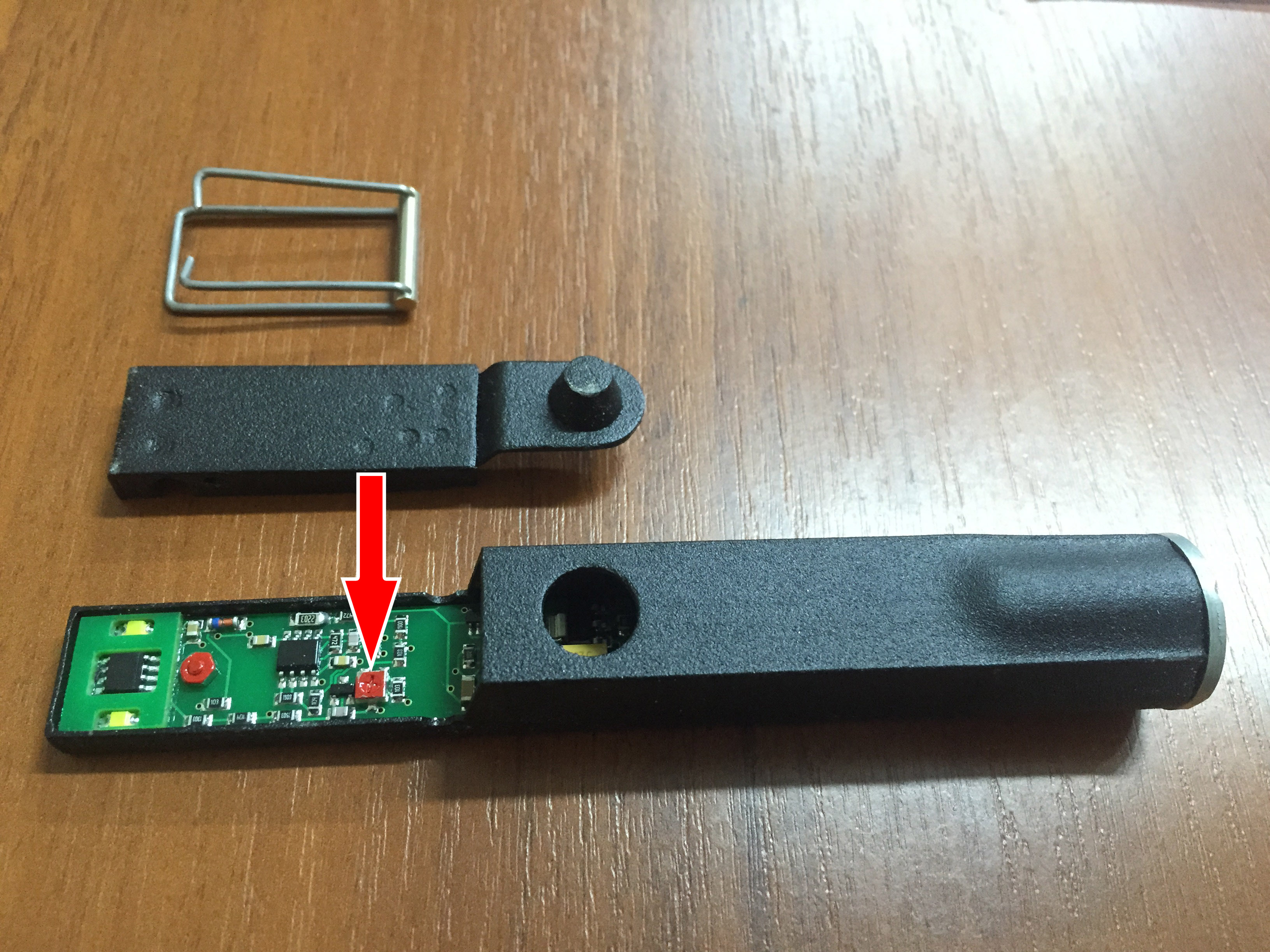

The only problem I've had is that when zeroing with the button on the CTi-M, it's still reading ~.1a on the screen. That's with the CTi-M in open air, not on a wire, and happens every time the button is pressed. Is there anything I can adjust on the CTi-m, or in the software to get that reading closer to zero?
Re: Zeroing the CTi-M
Post by Kelvin » Wed Nov 14, 2018 1:20 pm
Yes, you can adjust the CTi-M by yourself.

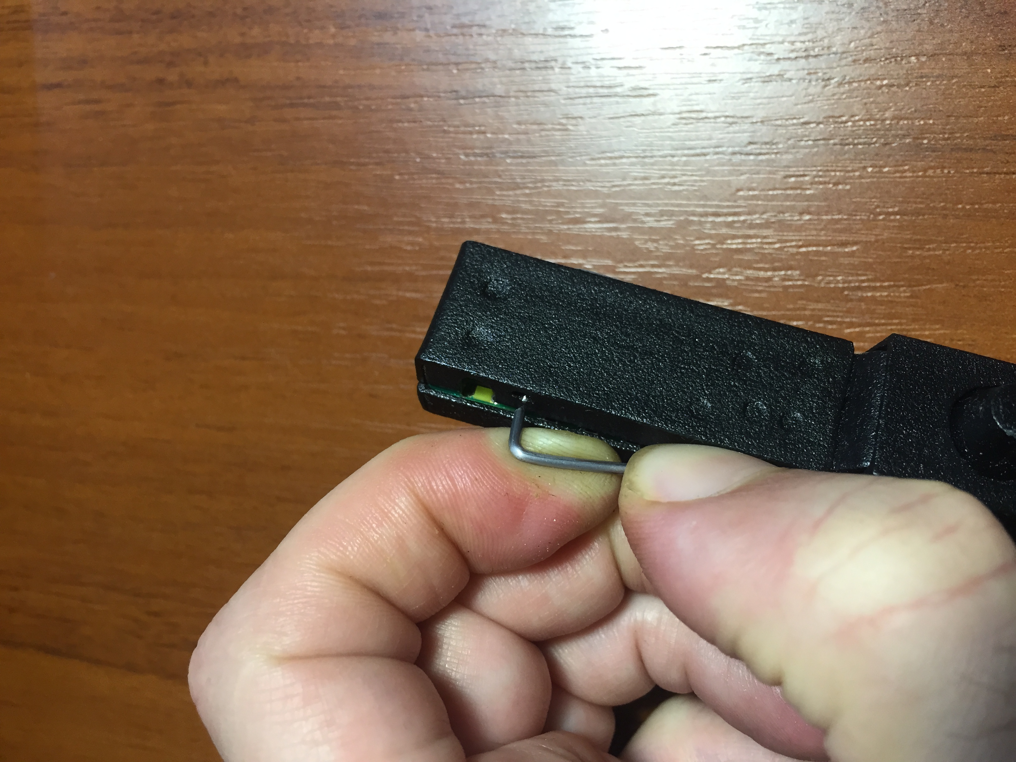

To do this, push apart the wire and remove the upper jaw.
Accurately adjust the required accuracy with a trimmer resistor, time to time pressing zeroing button and observing zero line on the screen.

That worked great, thank you!

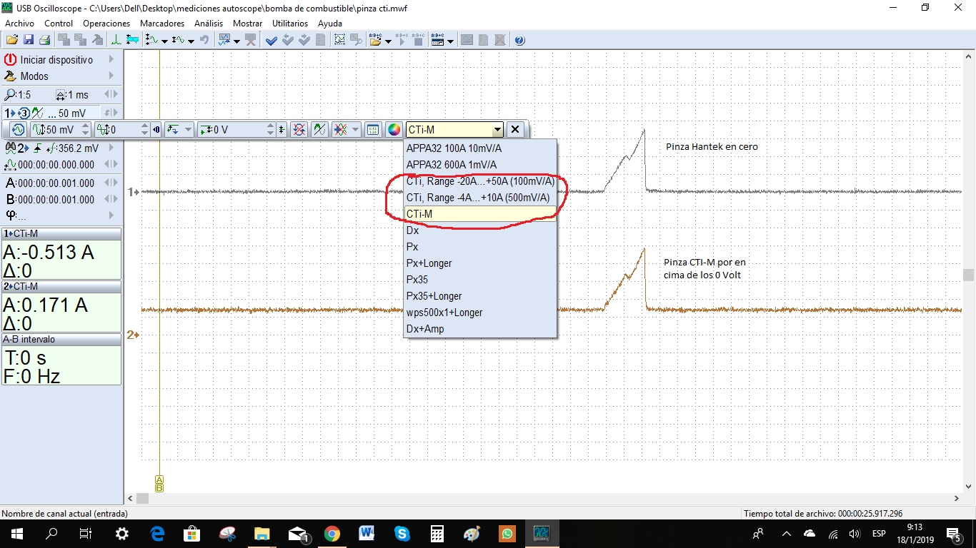

Hola colegas!!! Me sucede lo mismo.
La linea cero me queda por encima de cero.

2) Al seleccionar la pinza amperimetrica en el canal correspondiente, me aparecen tres opciones de selecion de pinza CTI-M. La que mejor me funciono fue la ultima de abajo CTI-M. Esto es asi??? Cual seria la correcta? Y las otras dos opciones para que servirían???
These two settings (-20A... +50A (100mV/A) and -4A.... +10A (500mV/A)) are used for previous model of CTi current clamps.
Now you should select CTi-M current clamps.
La medicion se realiza seleccionando 30x1 o 6x1????
You should select 30x1 mode.
