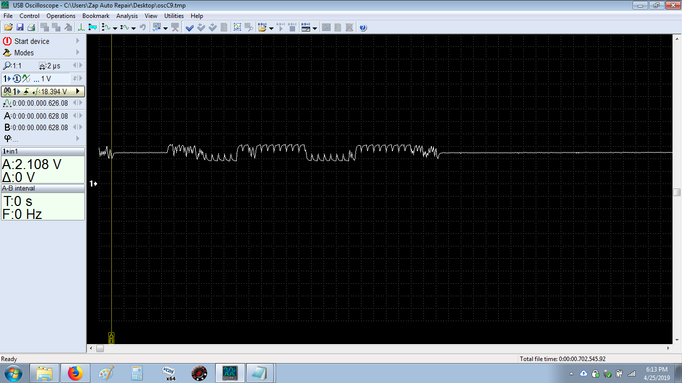

So, I had a 17 Audi Q7 come in today with communication codes. I attempted to scope the network lines, and this is what I got:

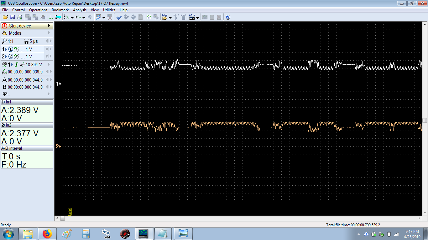

The picture above is with the sampling rate maxed out at 5Ms. I tried switching to a single channel and cranking it up to 12.5Ms. Below is what I got:
max sampling.png (69.54 KiB) Viewed 67867 times

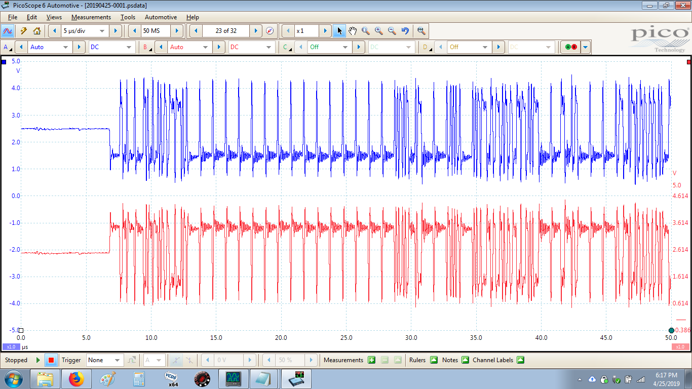

Still doesn't look right. After doing some research, I learned that this system on this vehicle uses Flexray. Just for the hell of it, I hooked up the shop's Picoscope.
pico flexray capture.png (162.18 KiB) Viewed 67867 times
It looks slightly better, but still not great. After doing some reading, I found that special test leads are required for getting a good signal with high speed signals like this. Here are the Pico leads: https://www.autonerdz.com/Blue%20Site/t ... 5large.jpg
I have two questions. First, it seems like Flexray is pretty close to maxing out the capabilities of the Autoscope. With the proper leads, can the Autoscope get a good pattern on signals of this speed?
If so, does Autoscope sell an equivalent test lead? If not, could I use the Pico leads with an adapter?

Post by Kelvin » Sat Apr 27, 2019 5:41 am
Yes, you can use the PIN3-BNC adapter together with the high-frequency oscilloscope probe, the distortion from the parasitic capacitance of the cable will be minimal.
PS:
Here, the pulse repetition frequency is 5 MHz, this is theoretically the upper possible limit of the bandwidth, which could be measured at a signal sampling frequency of 12.5 MHz.
In practice, the upper limit for USB Autoscope IV is 2 MHz.
