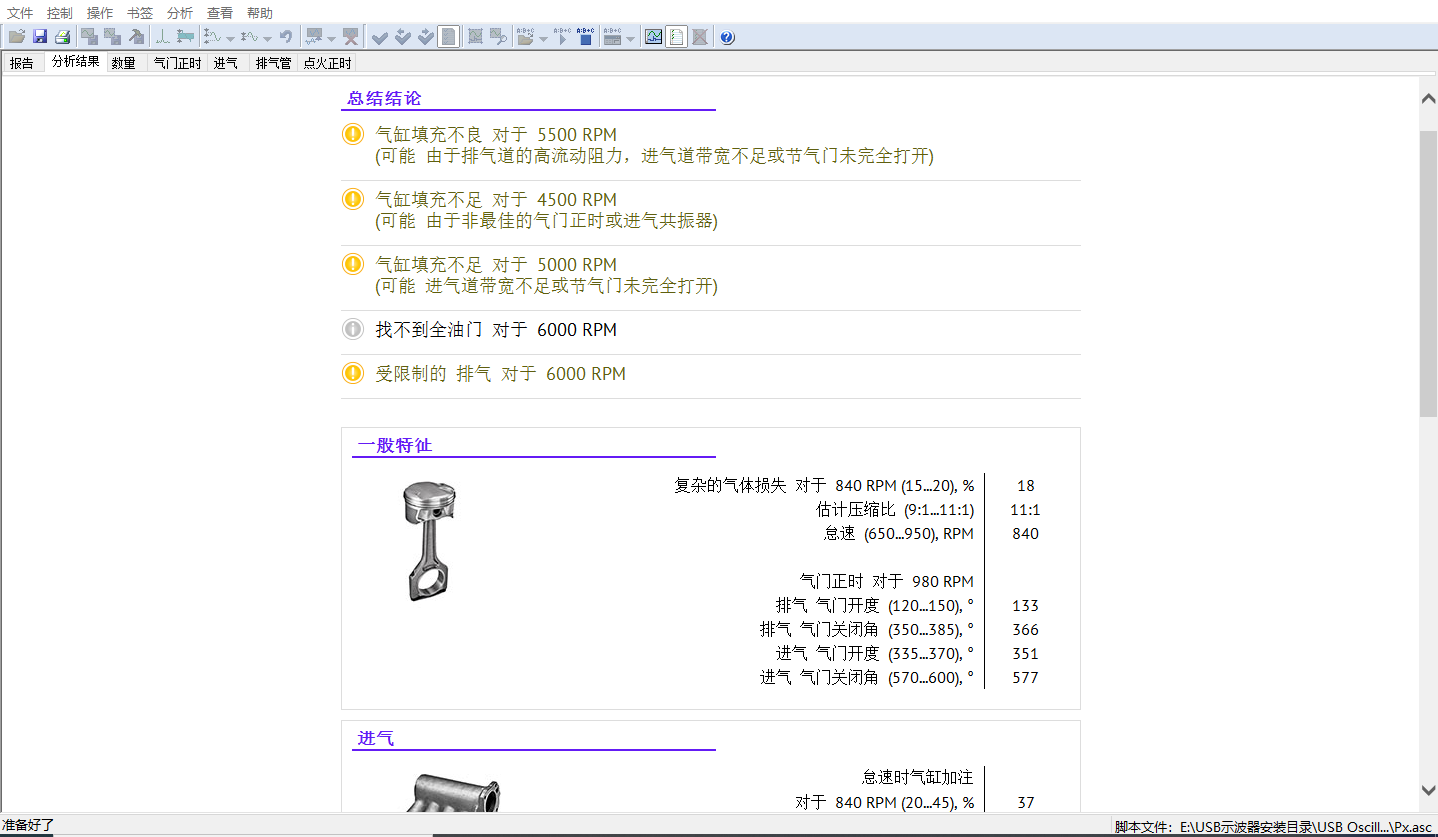

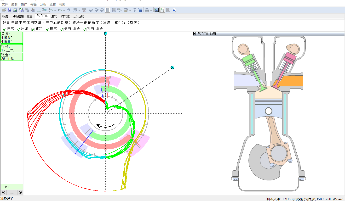

长安逸动1.6 JL478QEA发动机吴勇的车怠速真空不正常有时高有时正常1缸.psdata- (3.97 MiB) Downloaded 964 times

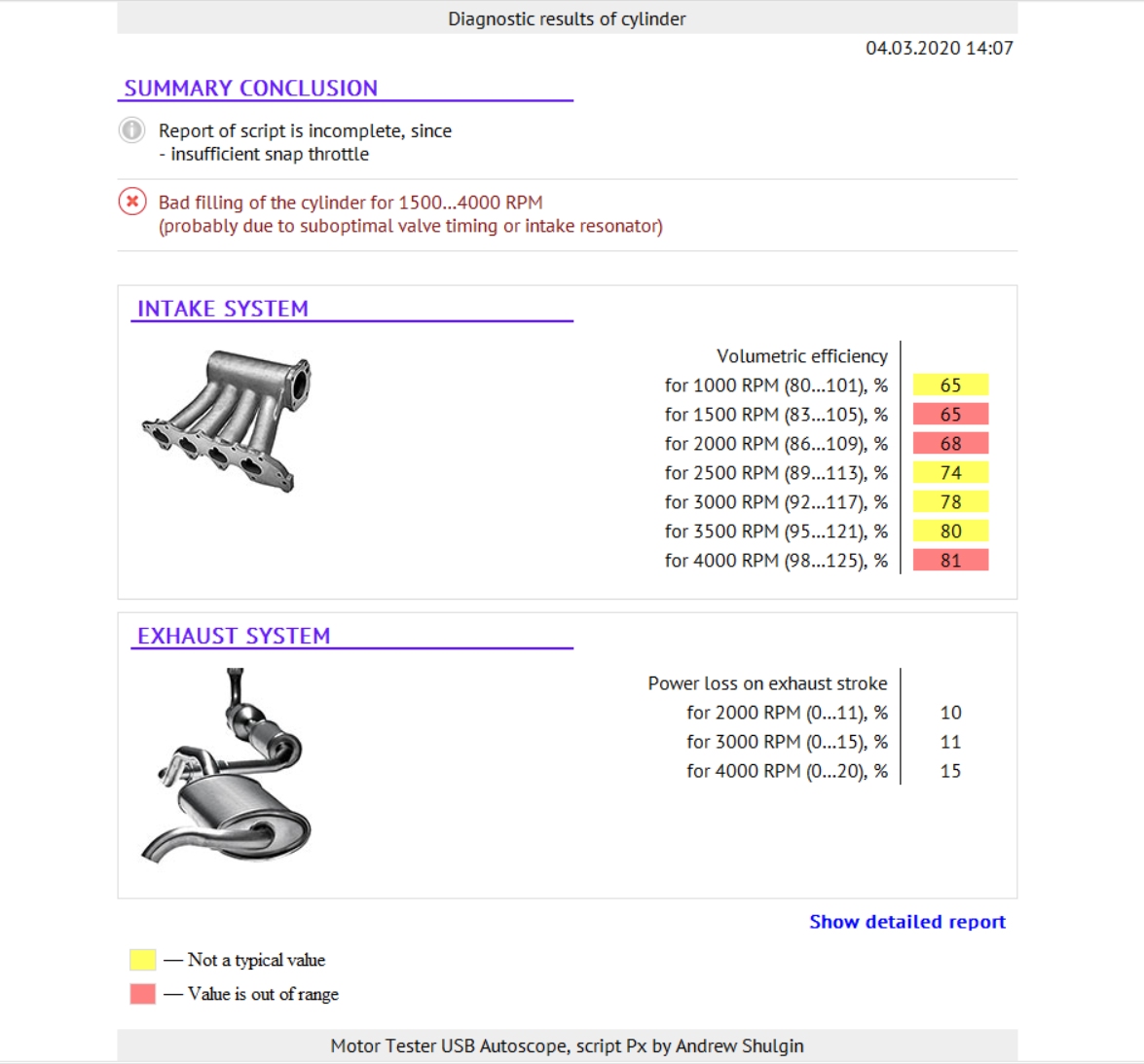

Your waveform has been converted to *.mwf format.
Unfortunately, your file contains 8 frames and script results are not accurate.
I recommend you to download Pico 4225/4425 settings needed to record properly the cylinder pressure waveform:
viewtopic.php?f=3&t=29
Record your waveform again according this test procedure:
https://youtu.be/H6ih-b9suSQ?t=71
- JL478QEA.png (226.92 KiB) Viewed 28415 times
长安逸动1.6 JL478QEA发动机吴勇的车怠速真空不正常有时高有时正常1缸_frame4.mwf- (196.23 KiB) Downloaded 878 times

- 2.png (91.95 KiB) Viewed 28403 times
- 1.png (100.84 KiB) Viewed 28403 times
