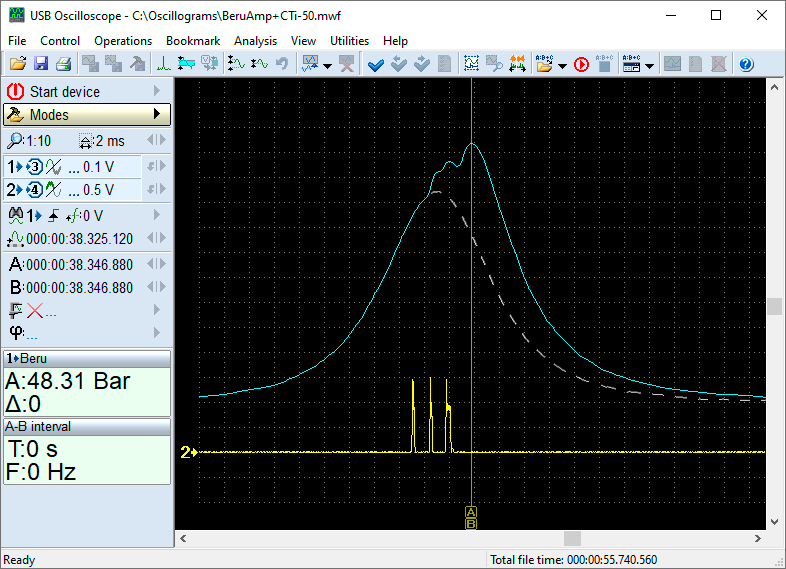

Here is an example of graph of the pressure in the diesel cylinder obtained using USB Autoscope IV automotive oscilloscope and PSG200 diesel pressure transducer:
The blue trace is the pressure graph in this cylinder.
The yellow trace is the control current of the fuel injector of the cylinder being tested.
The dashed white line shows what the pressure graph would look like if no fuel was supplied to the cylinder.

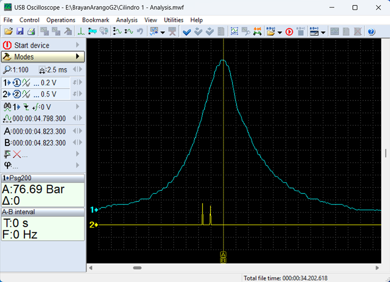

Here is an example of your graph of the pressure:
It looks like the pneumatic channel is incorrect, and the graph itself has incomprehensible distortions.
