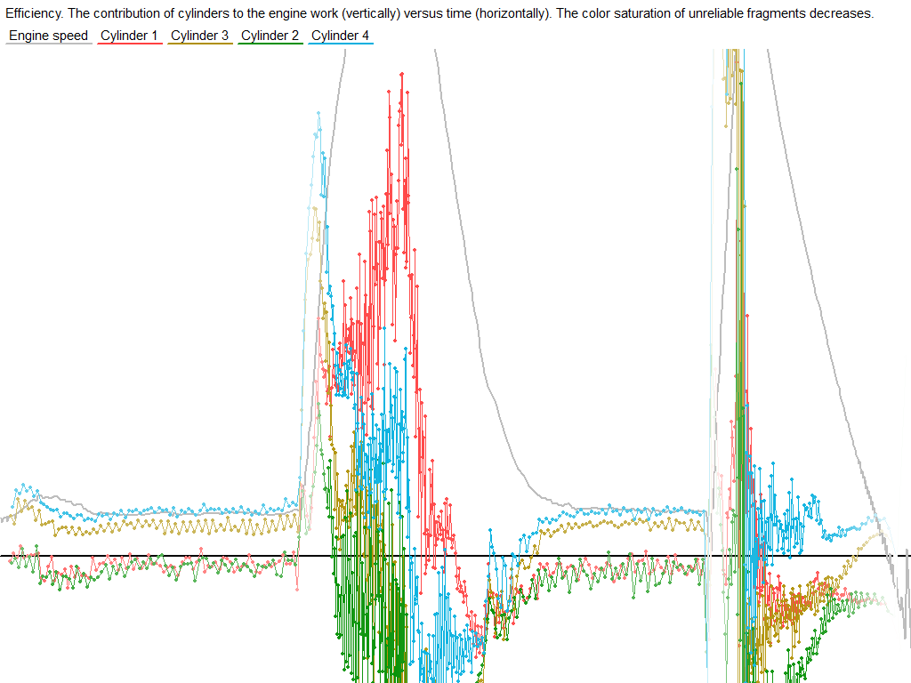

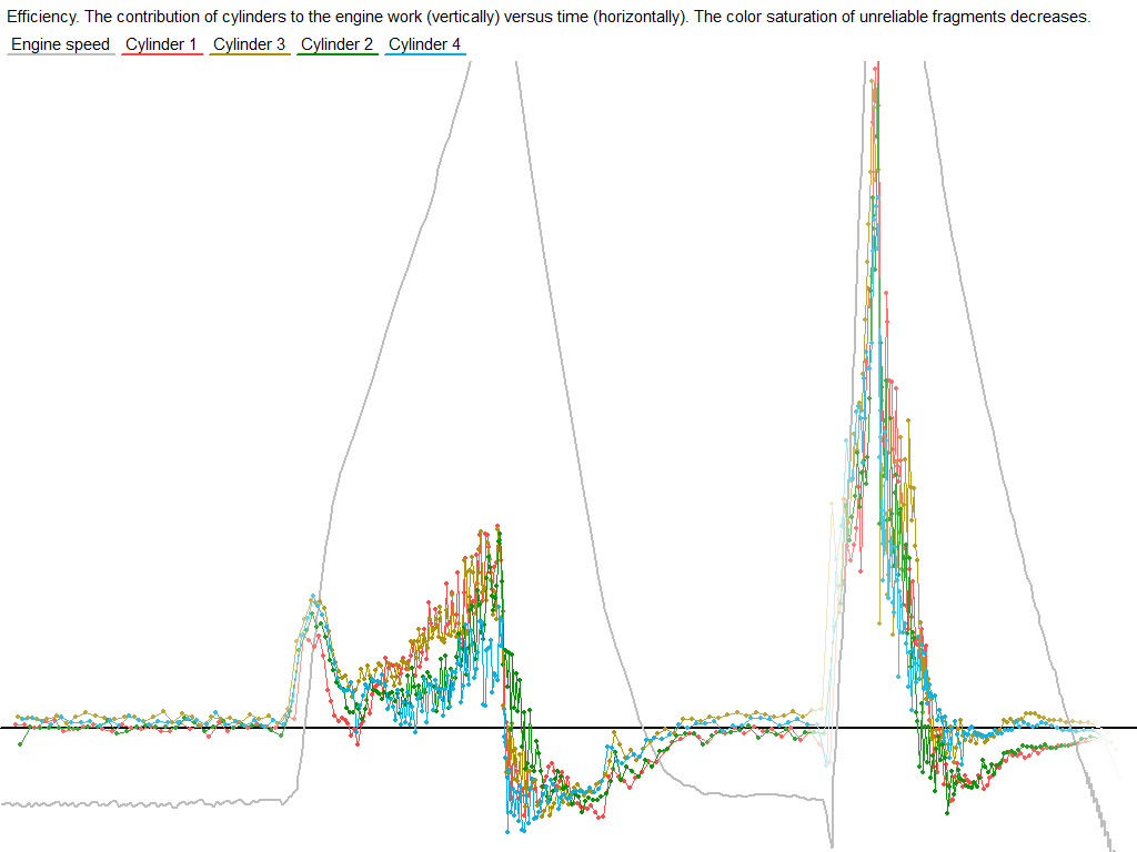

It was running rough, so I ran the CSS script. Here's what I got.
02 Outback 2.5sohc CSS.mwf
(8.19 MiB) Downloaded 1434 times
02 Outback 2.5sohc CSS.png (56.43 KiB) Viewed 36132 times

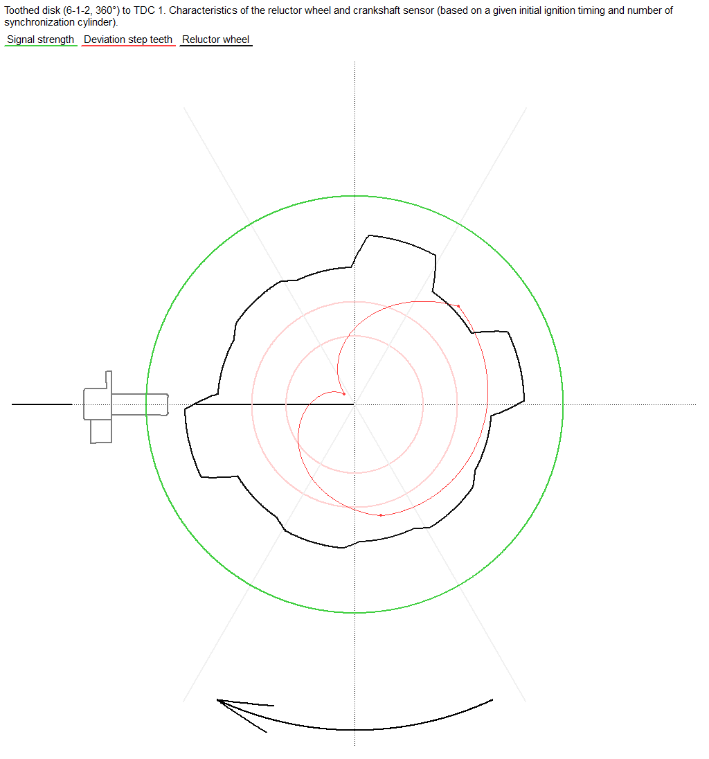

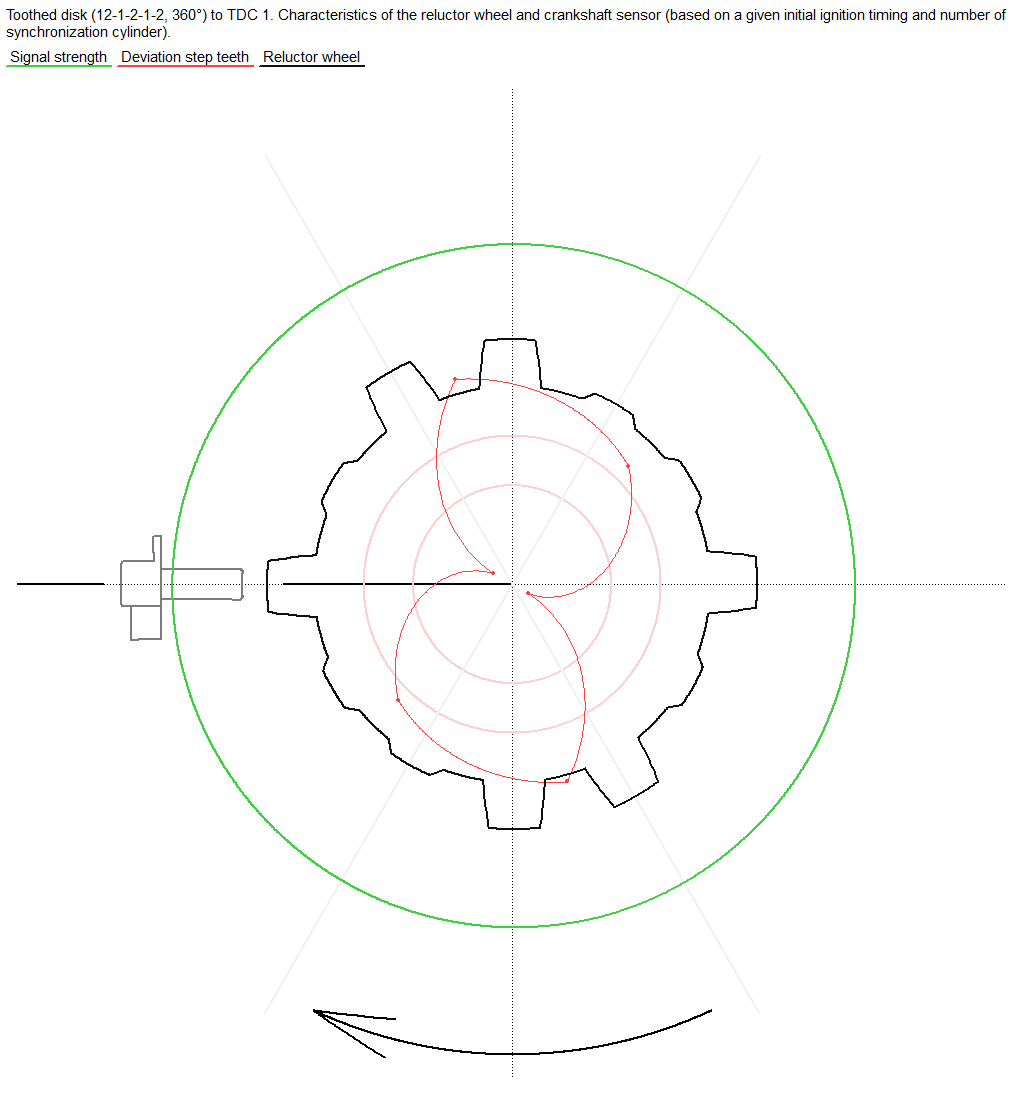

I looked at the toothed wheel screen, and was surprised to see a 6-1-2. I've never seen that before.
02 Outback 2.5sohc CSS toothed disc.png (32.58 KiB) Viewed 36132 times

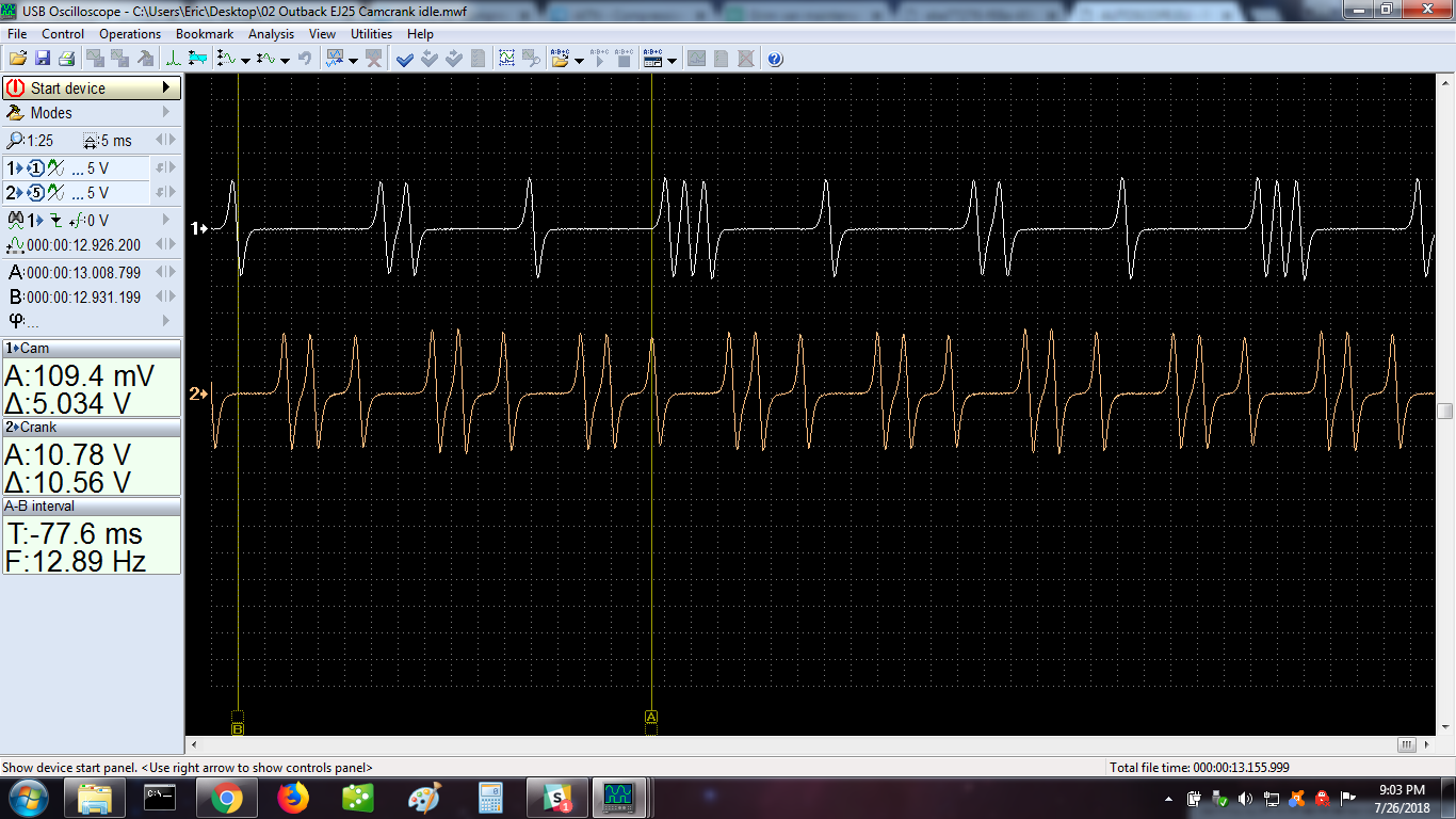

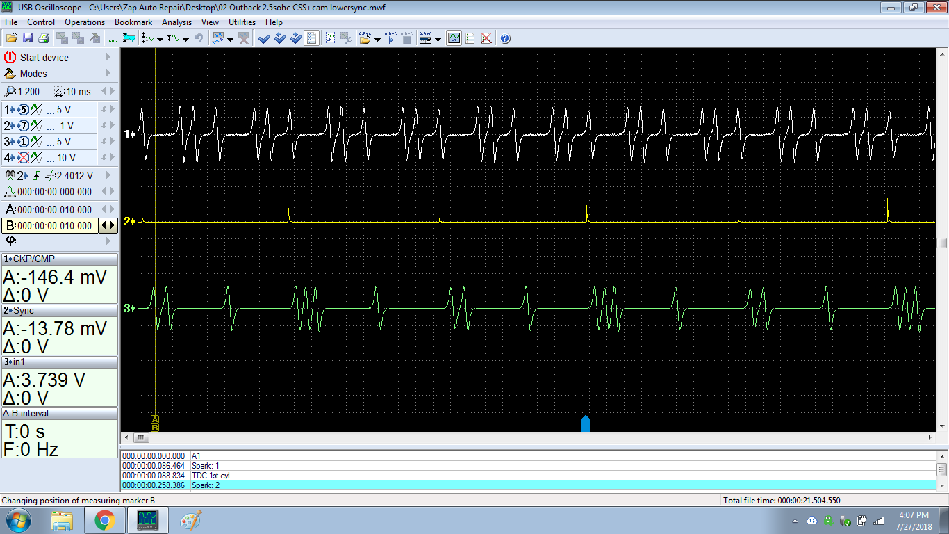

After doing a couple other checks, I decided to check timing.
02 Outback EJ25 Camcrank idle.png (160.94 KiB) Viewed 36132 times
So, based on this, it looks like it's actually a 12-1-2-1-2. Is it possible that's why the CSS script is showing 2 cylinders underperforming, because it's looking for 4 power strokes when there are actually only 2? Is there any way to correct the script and tell it what kind of toothed wheel the car has? Is it possible that because this car has DIS coils, it's seeing a spark every 6 teeth and assuming that it's got a 6 tooth crank wheel? Is there any way to adjust the trigger settings so it will only see the power stroke spark on the #1 wire, and not the exhaust stroke spark?

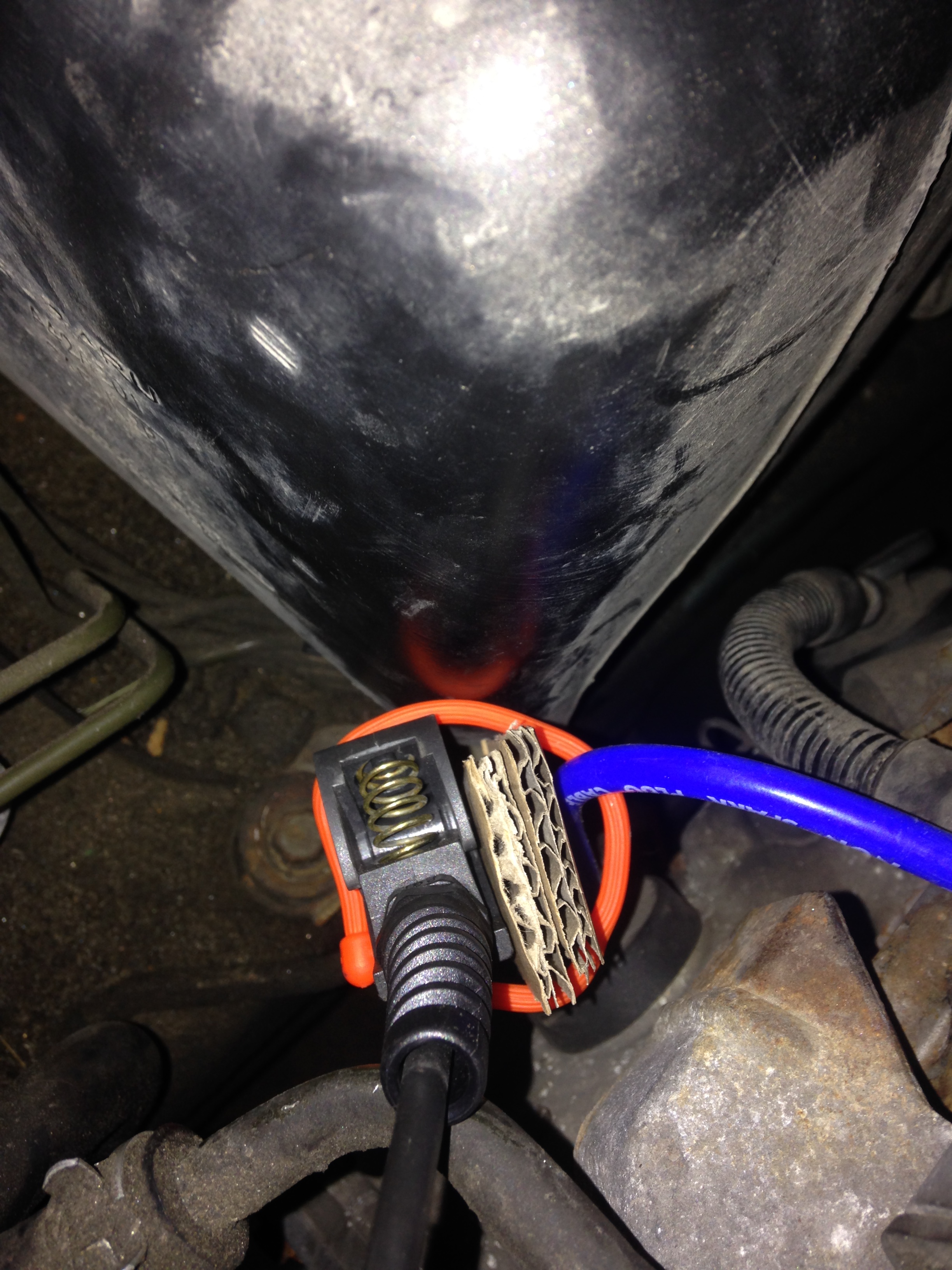

Well, it's not pretty, but I got it to work.
I was thinking that if I could somehow weaken the sync
pickup signal, that might allow me to only get the power
stroke sparks, and not the exhaust stroke sparks.
I let the vehicle run with the scope trigger set to the sync
channel, then moved around the sync clip until I could get a
consistent pattern. I found that if I pulled the clip about
half an inch away from the wire, I could get a pretty good
pattern. So, I rigged something up with a couple pieces of
cardboard.
02 Outback 2.5sohc CSS+cam lowersync.mwf
(14.79 MiB) Downloaded 1343 times
02 Outback 2.5sohc CSS+cam lowersync.png (82.58 KiB) Viewed 36127 times

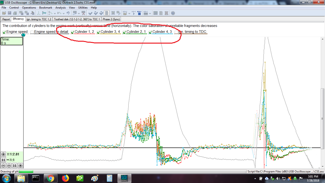

After doing that, the CSS script correctly identified the
CKP pattern.
lowersync toothed wheel.png (34.74 KiB) Viewed 36127 times
lowersync CSS.png (44 KiB) Viewed 36127 times

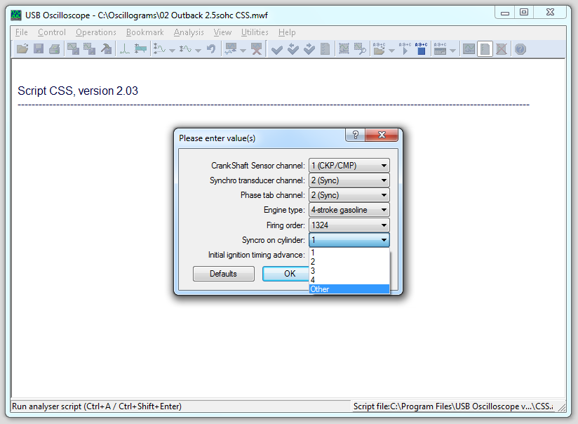

As you correctly have identified, the application has a hard time differentiating between compression and exhaust spark events, even though there should be a significant amplitude difference between the two.
There is a possibility you have a defective spark plug wire. You can try to sync from one of the other cylinders, preferably from, in this case, the other coil assembly.

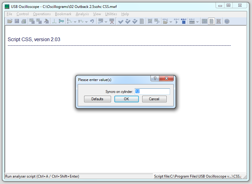

If you want to try with the existing recording, go in to the script configuration and select sync on cylinder "Other", then in the next window select cylinder "12" (cylinders 1 and 2), instead of "1".
Actually, you set the application up to trigger on the companion cylinders, so if the firing order was 1324, the setting would be 12.

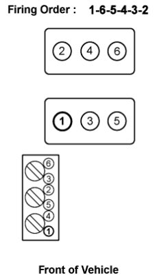

v6 firing order.jpg (11.84 KiB) Viewed 36107 times
So, for the vehicle pictured above, I would put the sync probe on cylinder 1, and enter 14 in the "other" box?
Is this the recommend sync setup for all DIS vehicles, or should I only use this method when I have trouble getting a good result with the default settings?
I notice that when I run the script this way, the cylinder labels now read "cylinder 1,2" and "cylinder 2,1". Can I be confident that the line for cylinder 1,2 is definitely cylinder 1, or does that mean that it could be cylinder 1 or 2?
Subaru CSS with 12 sync.png (157.18 KiB) Viewed 36107 times

Let's look at the example of this 6-cylinder engine with the firing order 165432. For such an engine the following sync options are possible:
1      (1 _ _ _ _ _),
6      (_ 6 _ _ _ _),
5      (_ _ 5 _ _ _),
4      (_ _ _ 4 _ _),
3      (_ _ _ _ 3 _),
2      (_ _ _ _ _ 2),
14     (1 _ _ 4 _ _),
63     (_ 6 _ _ 3 _),
52     (_ _ 5 _ _ 2),
153    (1 _ 5 _ 3 _),
642    (_ 6 _ 4 _ 2),
and
165432 (1 6 5 4 3 2).
The script automatically checks whether you entered the companion cylinders correctly, and in case an error is made, it automatically corrects it.
But, let's go back to the engine with the firing order 1324. Cylinders 1 and 2 are served by one coil, and cylinders 3 and 4 are served by another coil.
If we have a large sync pulse amplitude for only one cylinder, we need to specify only one cylinder in the sync setting. For example, cylinder 1.
When the amplitude of the pulses is the same for several cylinders, we can indicate that sync occurs in several cylinders. In this case, cylinders 1 and 2 have a common ignition coil. The exhaust spark of cylinder 1 is compression spark for cylinder 2. If the amplitude of compression spark and exhaust spark is the same, then we indicate the sync "12". But, in this case, the script can't know where the sparks of cylinder 1 and cylinder 2 are. Therefore, the script notes these graphs as "1, 2" and "2, 1". Analogically, the script can not distinguish cylinder 3 from cylinder 4.
In this situation, to identify cylinders during the test accurately, one of cylinders can be disconnected for a short time, for example, injector connector of cylinder 1 can be disconnected; then it will be easy to understand which of the graphs belongs to cylinder 1.
