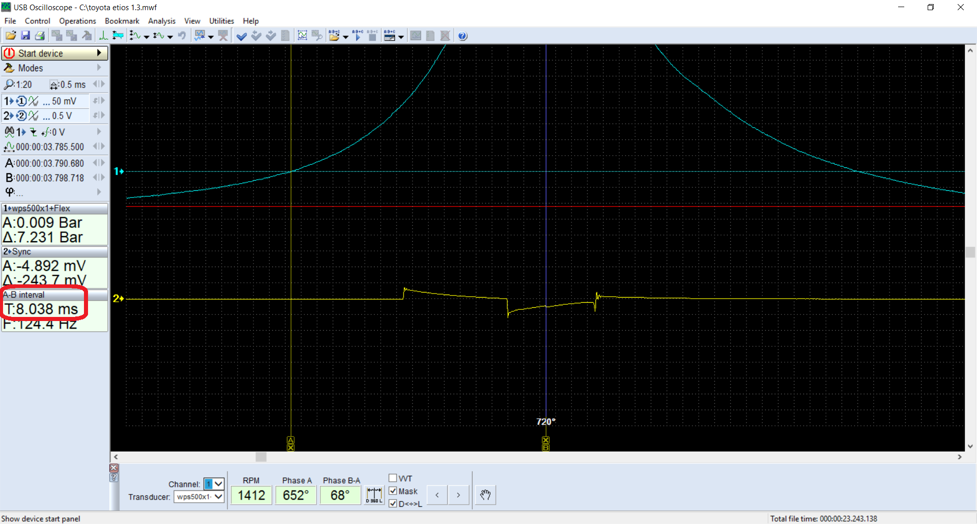

Post by cunha » Mon Dec 02, 2019 3:27 pm
Engine Working Fine.
No fault codes
toyota etios 1.3.psdata
(22.48 MiB) Downloaded 1876 times

Post by admin » Tue Dec 03, 2019 2:58 pm
Converted file is attached.
Please inform what type of the pressure transducer you use,
if you have WPS500, it is required to use our WPS500 deep well adapter for correct measurements.
toyota etios 1.3.mwf
(19.73 MiB) Downloaded 1997 times

Post by cunha » Tue Dec 03, 2019 5:25 pm
I am using the regular WPS500X
What kind of mistake can have in this case (this signal that i have aquired).
What is your "deep well adapter"?
Tks

Post by Kelvin » Tue Dec 03, 2019 10:10 pm
Hi,
I think standard Pico adapters don't work properly because of wrong construction.
There is a parasitic volume that distorts the measurements.
It's better to ask about WPS500 deep well adapter directly support@usbautoscope.eu
