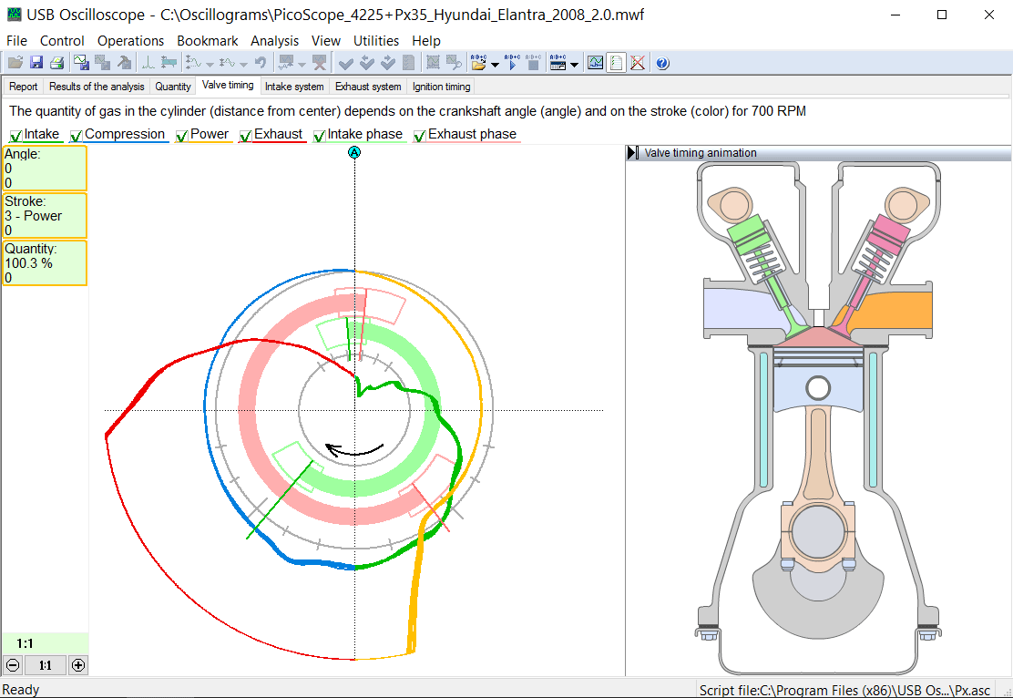

To run automatic analysis, in the USB Oscilloscope software select menu Analysis => Execute script

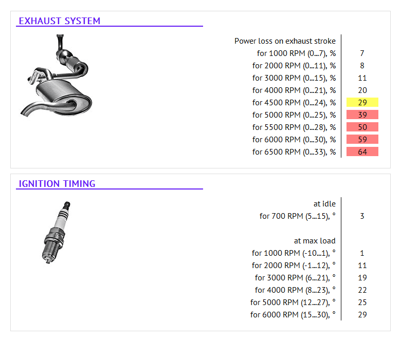

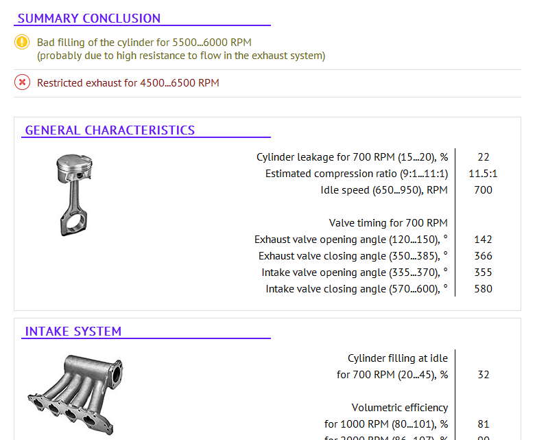

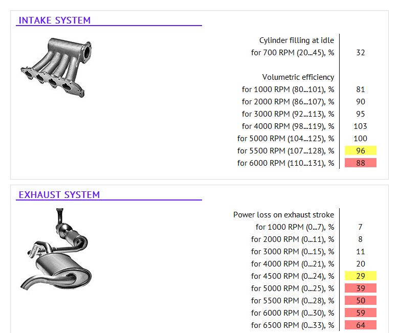

Script reported about the restricted exhaust!
I will remove the exhaust pipe and check.
